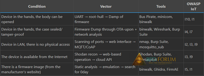

2. If the web interface contains a diagnostic form (ping, DNS lookup) - command injection check: ; id, | cat /etc/shadow, , whoami. 3. Analysis of API queries via Burp Suite: there is often no authorization on API engrades - IDOR, mass assignment, access to other people's devices through the search of serial numbers. 4. Checking the firmware update mechanism: If the device downloads an HTTP update without a signature verification (OWASP IoT I4), it is possible to change the firmware through MITM. 5. For devices whose web interfaces are available from the Internet, Metasploit contains modules for a number of popular IoT platforms. In msfconsole team search type:exploit iotwill show the available exploits; search type:exploit routerand search type:exploit camera- additional modules for specific classes of devices. Application Context: decision tree selection vector The choice of attack vector on the IoT device depends on the terms of the project. Below is the diagram that I use to prioritize: [ATTACH type="full"]5480[/ATTACH] The principle is simple: if there is physical access - start with iron. UART-wheel in 15 minutes gives more information than three days of the phase-over interface. If there is no physical access - firmware from the manufacturer's website + network analysis closes most of the scough. Restrictions and where the methodology breaks down Not every IoT device is amenable to the process described. Restrictions that I face regularly: • Proprietary RTOS. Devices on FreeRTOS, Zephyr or fully custom firmware without Linux kernels are not unpacked by binwalk. You need a full reverse in Ghidra from scratch - these are days of work, not hours. On one project, we spent four days only to understand the file system format. • Protected chips. Processors with Secure Boot, TrustZone and burnt fuse bits block firmware reading and turn off JTAG. Bypasses required llitching-attacks (voltage fault injection) - specialized equipment (ChipWhisperer, ~$250-350) and expertise. It is not “connected and removed the dump”, but the research work. • Encrypted firmware. If the firmware is encrypted and the key is not extracted from the bootloader - static analysis is not possible without hardware attacks on cryptography. • Emulation. FirmAE and Firmadyne work with ~70% firmware based on GNU/Linux. The remaining 30% require manual QEMU or not emulated at all due to the tie-in on proprietary hardware modules. These limitations do not mean that a punch no is possible – they mean that the scump and budget should take into account the actual complexity of the device. Two-day IoT-pentest covers the network layer and superficial firmware analysis. Full-fledged testing with a hardware level and reverse is at least a week per device. Conclusion In the seven years of working with embedded systems, I came to the conclusion that the main problem of IoT security is not the complexity of attacks, but the elementary nature of most finds. Hang-shaped passwords, open UART with root-coul, MQTT without authentication, HTTP updates - all this OWASP IoT Top 10 2018 Category I1 and I9, and they cover the vast majority of real vulnerabilities. Manufacturers of embedded devices in their mass have not yet passed the path that web development took ten years ago.
